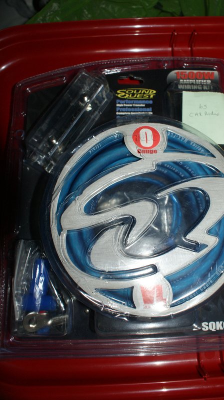

  • Kit de Cables: Calibre 0
    Sound Quest CCA 1/0

Cables
